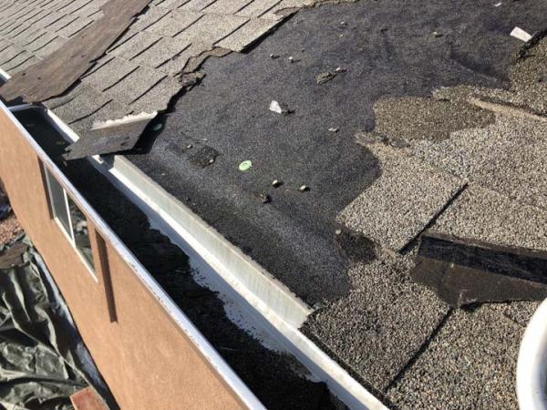

Documenting your jobs pay off! This one picture was worth $2,000.00! The insurance company didn't include gutter apron stating that is wasn't damaged and therefore didn't require replacement and wouldn't be included in their estimate. The Ice & Water is sealed to the Gutter Apron therefore it requires replacement. The Gutters would also need to be detached and reset because they were attached through the gutter apron. THIS IS WHY PICTURES ARE WORTH A THOUSAND WORDS & a couple thousand dollars!
ice and water - gutter apron - gutter detach and reset
Let's see where your documentation made you more money!
